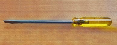

Found a CTC marked screwdriver this week. It is has a 6 flute translucent yellow handle with a once-plated round shank and is 12.1 inches overall length. The only marking is "CTC".
Since the "CTC" marking seems to match the "CTC" on a screwdriver that Lesserstore found in post #1 that had an NSN marking I'm guessing this screwdriver was made by the same company that made that one. And, though the drivers in the ebay listing that Lesserstore linked to are no longer viewable through that link, it looks like he was able to connect his 5120-00-764-8102 to drivers that were made by Century Tool Co.?
Also, the CTC marking on the one I just found matches the CTC on the ebay drivers that also said "J&H".
So... I'm assuming my screwdriver was made by Century Tool Co. and also could have had a connection to J&H. At least that is my best guess.

You have an FSN on yours, the precursor to the NSN, used from 1955-74. NSNs are basically FSNs with a country code added, like mine has -00- which is the code for the US.

BTW the other CC for the US is 01 and NSNs with that one were assigned beginning in '74 or '75, the former being the year NSNs came into being.
