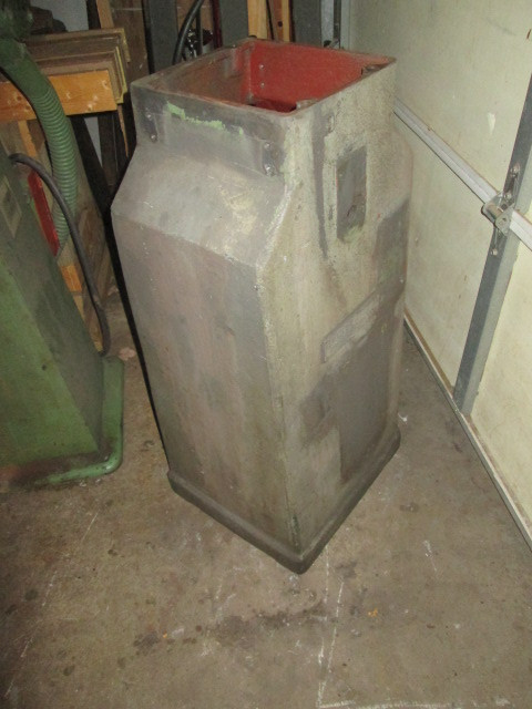

What I'm looking for is the outer housing from a CV-Joint!
I'm not sure what it came from, But there's a part# inside the housing showing Spicer F2-99-89
I currently have 3 of these & I would like to find another one so I can use them as feet for a grinder stand I'm working on.
The condition of the CV Joint housing is not a issue & it could even be broken or cracked, As long as the pieces are there.

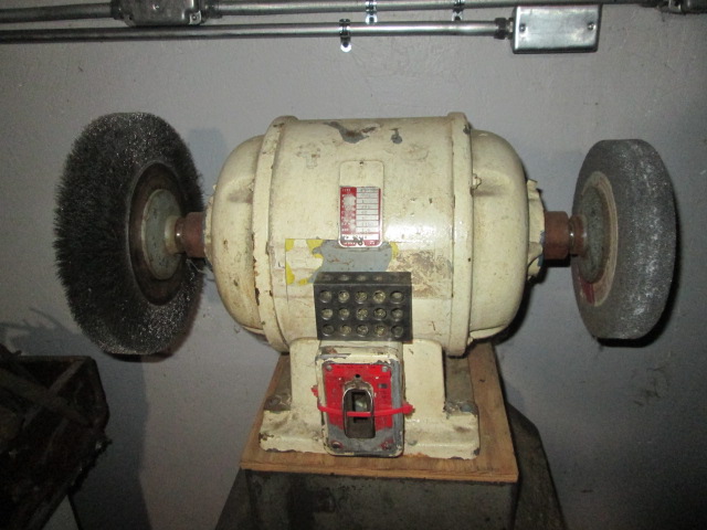

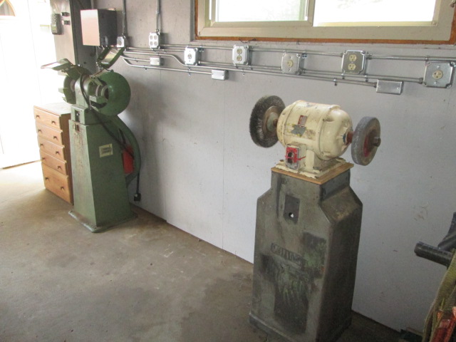

Plus the grinder I'll be using is an old 1HP. 3PH. Standard Electrical Tool Co. grinder which probably weighs close to 75lbs. Even with a heavy stand/base it will tend to be top-heavy.
Here's a pic. of the grinder with a 1-2-3 block sitting on the switch box for size comparison.
Another thing to consider is that I'll be using it mainly as a wire-wheel & even more lateral pressure is used during that type of use.

Wire wheel will definitely want lateral force to use and with the center of gravity being that high it will do a tip-over or "climb" up the workpiece at you. I would seriously suggest some guards on that. Dressing the grinding wheel will sling abrasive **** all over you if unguarded. Wire wheel can also spit the needles out as they let go, I've been macro-punctured by these now and then and sure wouldn't want one inserted in my face. I once worked at a larger company in the machine shop that had a pedestal grinder a bit larger that had the wire/abrasive set-up like yours. A guy that should have known better was using the wire and it dragged him in, threw the workpiece into his chest, and knocked him out. Myself and the shop painter were nearby, picked him up, and carried him (unconscious) to the plant nurse. My whole point is that a 1 HP motor has enough torque to do some serious damage to you in a heart beat. If it tips over it will climb the wall, chew your body, or launch a workpiece and you won't be able to stop it. Apologies for sounding like the safety police, just don't want to see you becoming the ****** mess the other guy did. I'd strongly suggest bolting that damn thing to the ground, wall, and fabricating some guards for it. Having said that, wish I had one like yours for my shop.

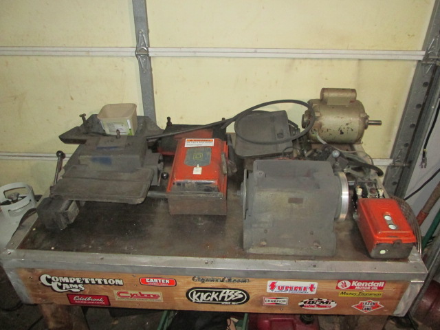

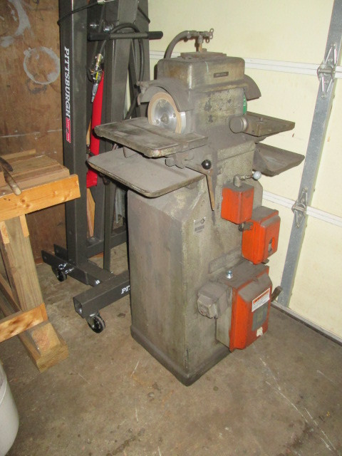

I'm going to be making guards for it that will also have dust ports since it will eventually be connected to a dust collector for metal. That grinder & several others are not even wired up yet! The pics are from me temporary setting them in place to figure out where to place some new circuits I recently added after installing a new sub-panel.
The grinder I need to make the stand for is temporary sitting on a cast-iron stand that belongs to a carbide grinder that's next in-line to be rebuilt. Once finished I plan to put that in-between the other two grinders.

How are you going to level it?
The area I plan to put the grinder is pretty level already, I would probably just need to raise the front a little bit.
The top of the CV shaft is threaded 3/4"-16, I figured I would just weld a nut onto the end of the legs. Then I could use a thin jam nut to lock the foot in-place.

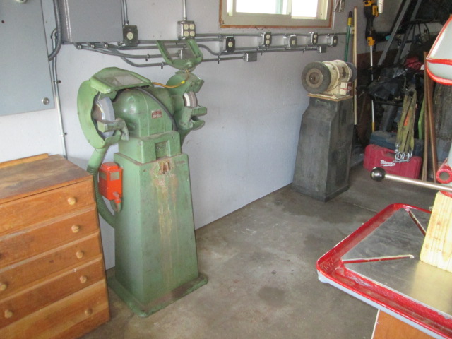

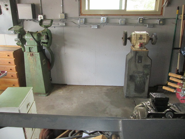

O.P. I have to say, that is a great looking conduit install where you have your grinders positioned.
Thanks!
I was pretty happy with the outcome seeing this was my first attempt at actually bending the conduit. On other smaller projects I would just use the pre-bent stuff.
The box above the grinder on the left (last pic) is a DIY 3 phase fuse-box that's fed from my rotary phase converter. It's currently not wired yet, But the grinders will be hard-wired.
