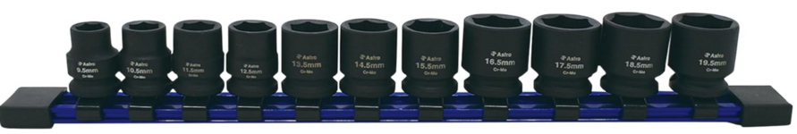

  • 6 point shallow sockets by Astro Tools 783111, 9.5 mm, 10.5 mm, 11.5 mm, 12.5 mm, 13.5 mm, 14.5 mm, 15.5 mm, 16.5, 17.5 mm, 18.5 mm, 19.5 mm
