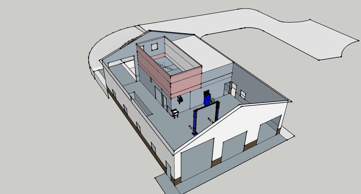

I am planning a 46 x 60 build with a 14 x 30 room upstairs . That room will be office space/kitchenette/etc.
Any thoughts on flooring for a situation like this?
I would have posted this in the "Flooring" section but that seems to centered on garage flooring.
Click here to see a 3-D sketch that shows the "upper room". The upper room is shaded a dark pink.

What will you be doing on your way to that room? Soldering circuit boards? Slaughtering hogs? Oil field equipment repair?
For me, with mostly wood working and car repairs, I'd be in some sort of athletic shoes or boots, so I'd go with whatever was durable and a good price. Institutional carpet, probably.
If this is going to be a business, or otherwise have people who aren't you in it, the overall finish might be entirely different. I've worked in places that would have had bare ply in that sort of room, and places that had cable tray in the floor, so they had data center type floors throughout.

Woodworking, lawn work & working on cars are all likely activities prior to going to this room.
It's also possible that there might be a poker game or such take place in this room.
I'm leaning towards sheet vinyl for ease of cleaning and stain resistance but I thought I'd toss it out to the group to see if there's something available that I might not be aware of.

Yes, it is quite possible that friends/family will hang out. I plan to have a small kitchenette type set up along with a place to do paper-work.
I probably muddied the water by calling it an "office" but paperwork and perhaps working on electronics would be done in this room as well as some beer drinking and such with friends.

My suggestion is to go to a lumber liquidators and check out the flooring they have on hand. You may find some really good flooring for a decent price.
boobag
Aug 15, 2010
397
i'd probably do VCT vinyl composition tiles. they are cheap and wear great.
mikec35
Jun 17, 2011
1,258
NC
Vct is quick, cheap and easy to change pieces as needed. You could get a couple of different colors and have a nice checkerboard pattern.

What is in the room below? Is that a pit? I could see replacing 3 doors with 2 on the end and moving hoist along wall?
S
sbosecker
Sep 25, 2012
3,539
Peachtree City, GA
sberry,
Wood Shop & bathroom.
Is that a pit?
On the plans it is labeled a "Tornado Shelter". It was either that or a "Wine Celler". Ha!
Thanks. Any thoughts on flooring in the upstairs room?

If it was mine, I'd be looking at some "office" type carpet. You can usually get it at a big box store for 50¢/sqft. If it gets dirty or whatever in about 7-8 years, just tear it out and replace it.

I like that. Its fundamentally a good design. I suggest moving the hoist so it leaves the floor space open, moving it to near an edge leaves only 1 post out in the floor space and not so far, makes it wide open.
I would trade off a bit of space to have office and coffee clutch on the first floor with the entrance near the man door, enter building, either walk in to shop or spin a turn in to office chair.
I believe that is a laundry tub, that looks good, it needs to be "on the way". Between the office and the shop.
sberry
Jun 18, 2005
35,747
Brethren, Michigan
14x30 is pretty respectable and could go to 34 by cantilevering the end in the center over laundry tub, tool boxes, some bench maybe.
If I was really going to occupy this a lot would really fuss with the door/ergonomics layout so I walked in, either went to office or up stairs. Stack the plumbing for a wet bar u there with full bath.
Down on the floor would have a stool, urinal, vanity sink with the laundry tub on the shop side.
