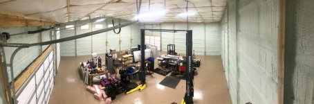

Insulation in and 8' wall covering going up (internal horizontal studs and 3/4" BCX plywood) on two walls to get storage and benches set.
Electrical too over the next few months. Power all over will be nice. Maybe a mini-split heat pump by the hot season.
Getting some experience with projects using the building, we'll be able to start tying down layouts and get a better "plan" for the work spaces. I realized that I don't have enough experience with this kind of space(s) and I intentionally have been working in flexible configurations, some better than others, but lots of carts, mobile work stations, and lots of trips in and out of storage "piles" to get materials and tools. Also the tools are spread out between the house garage, the basement, the shed, and the barn.
I'm envious of the threads on here where people have a very deliberate plan and the tools in hand to dedicate the spaces to the nearest inch for using them. Right now I'm: build it with screws, you know you will take it apart and change something - that next project will require 6 more inches / that next tool will need 1' more space. I do have an overall goal for the back corner (POV of picture 1) for a loft so everything is planned for that, but otherwise, I've had mixed success on committing, so I may try a complete layout revision when I clean and move it all back. On to the walls this evening!

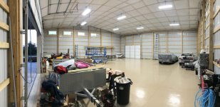

2. Finally got everything put back from the insulation, it was suprising once all the vehicles and items were back how much they took up when not efficiently placed. I have one more parts sorter and 4 shelf units to get on the far wall so everything can be off the floor. I also need to figure out an easy kayak storage system that may be similar to the board / exhaust storage system.
I also had to clean most of the shelving and items that weren't covered. I did put some of that furniture to use though and now have a nice space in my basement.
