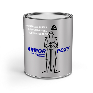

Ghostshield is a penetrating product, not a topical sealer they chemically reacts with the concrete to prevent oil and liquids from absorbing in. It works very well but once it is applied your floor will look virtually exactly the same and could continue to dust a bit. Topical solvent based sealers (we offer this in our ARM6415X) are excellent but not very resistant to oils and fuels.
A good solution though that looks like a sealer but is extremely resistant to automotive fluids is our SPGX one part Polyurea which can be applied to concrete. Thousands of happy GJ users over the years.
