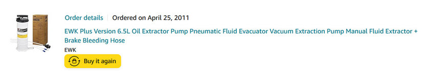

I've got an EWK Plus 6.5L manual pump one. It gets used quite a bit, though mostly by my sons for their bikes, boats & wave runners. I use it more sparingly. I don't use it for oil changes. I like getting under our cars & trucks to pull the drain plug and and greasing everything with a zerk and otherwise inspecting everything while I'm down there.
Was looking through my order history to see when I got it and didn't realize I'd had it even half that long.
Apparently it's been a good one. Not a lot of my plastic goods last that long.

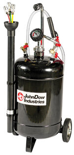

I have the john dow pneumatic with hand pump, as well as a 5 gallon bucket with a 12v pump on it for boats.
I find the pneumatic one does a great job of getting all the oil out. I still get under the cars every couple changes to inspect and grease (truck).
