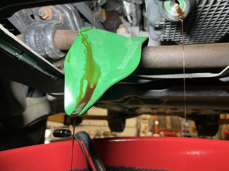

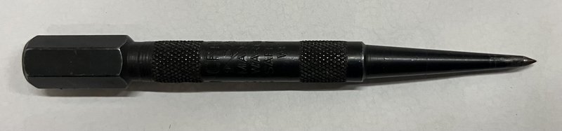

I don’t need a punch on my current fleet but I do have a couple things that help redirect oil..
I made this oil filter punch years ago using a nail set: Fluids flow perpendicular to the surface it is coming out of when passing through a small hole so it is easy to aim the oil to the drain pan.

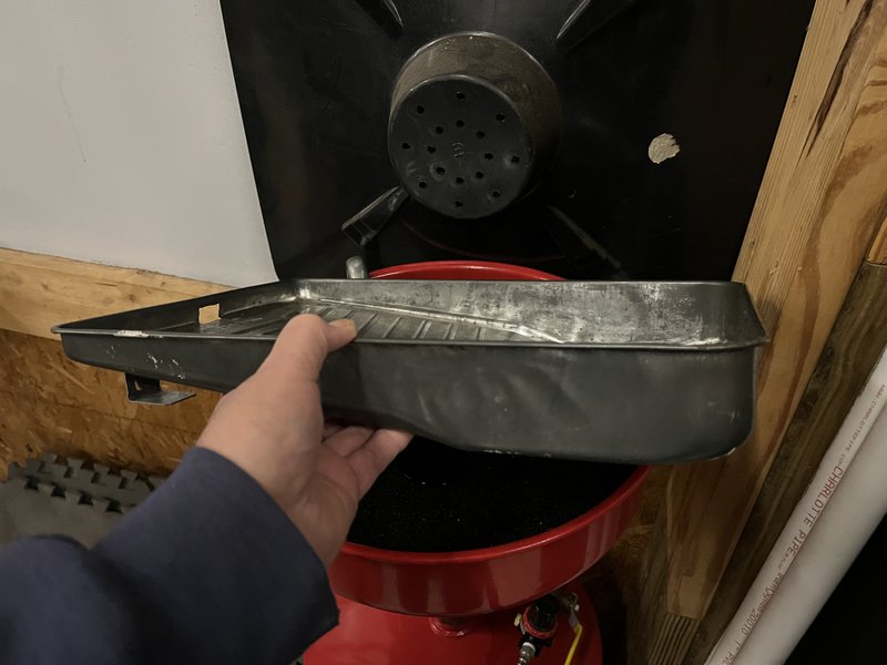

This paint roller pan was converted to a funnel to direct the oil coming out of the filter a drain plug on my motorhome. The Ladder hook portion of the drain pan hooks over the front sway bar.

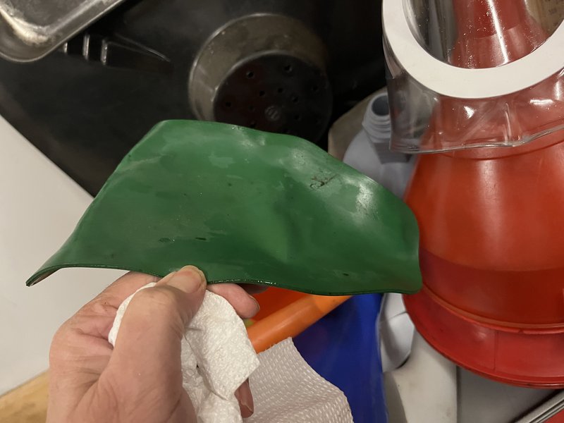

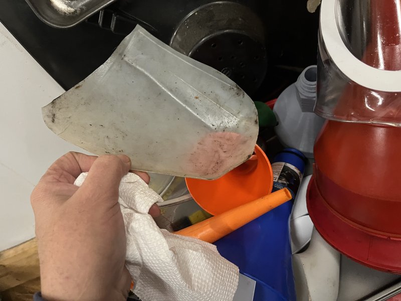

This flexible funnel comes in handy but heavy duty aluminum foil works too. I currently use it to keep the last bit of the oil from the filter on my grand Cherokee from gettin in the splash shield.. The engine has a built in funnel to direct the oil out of the service hole in the splash shield but when the flow slows down the oil don’t quite make it to the service hole.
This milk jug piece helps direct the flow from the filter on my Onan generator.
