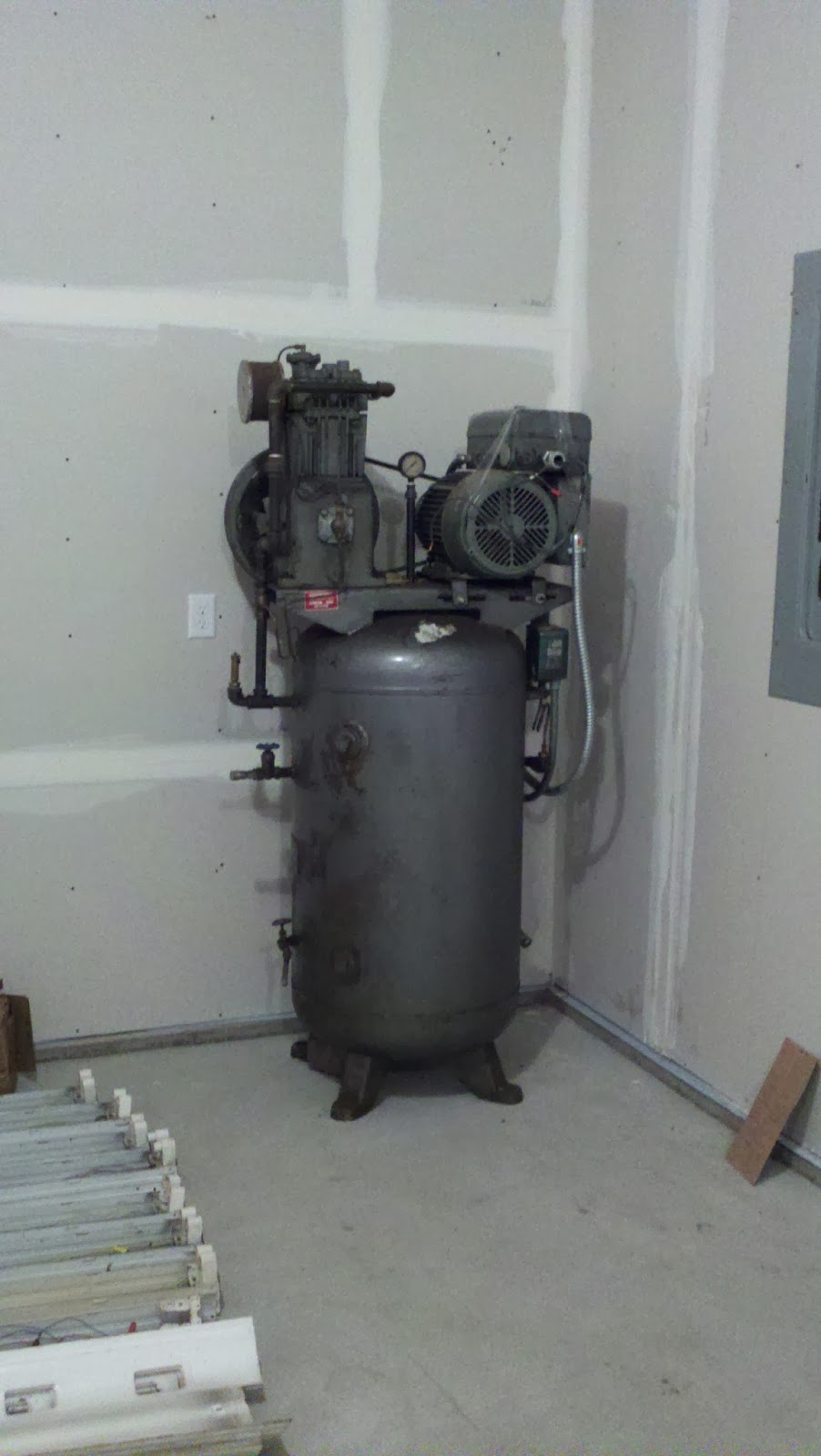

Hey guys, looking for some help diagnosing what's wrong with my compressor. I picked it up at an auction a little over a year ago, and its been running strong since. Its roughly a 1950 Quincy 325 for the compressor, the tank is a little newer.
I had the tank inspected when I got it, got the green light and have been using on weekends since then. Very light use. Went out the other night to use it, and it wouldn't turn on.
I started checking the voltage coming into the contactor, and it had 120v at the entry to each leg, but not on the outputs.
So I check the pressure switch, and I think its working. It had continuity across the switch, so it should be working, right?
I used a clamp to hold the contactor, since the coil wasn't, and that gave me continuity across its leads then. So I tried applying voltage, and had 120v at each outlet, but the motor wouldn't start. Next I opened it up, and pulled the tape off the lugs for the voltage inputs.
It had 120v at each of the copper lugs shown, but the motor didn't budge. Doesn't sound like its even trying to start. Is the motor dead? Can it be fixed? Can I do anything to see which piece inside the electric motor died? It also seems like my magnetic contactor is dead too, but it doesn't seem like its the only issue? Anything else I should check or try? Thanks.

Its a 230v motor, has 120v on each leg, so there's 240v there for it. The reset switches aren't tripped. Neither is sticking out, and both fuses are intact.

Please check voltage between the two motor leads. I know you show 120V to ground for both of them, but verify that there is 240V between them.

He saved me the typing, make sure you have your 240v as the 120 will come in one side and go out the other and make all look good.

To measure between the two motor leads, I just put one on each, as opposed to the ground, right? Because it measure like 0.05 volts between the two hot leads, but still 118v from each lead to ground. I take it this is bad.

Here's what I measured:
L1-ground: 118v
L2-ground: 118v
L3-ground: 118v (not sure why its jumpered between L2-L3)
L1-L2: 0.06v
L1-L3: 0.06v
L2-L3: 0.06v
L1-T1: 0.06v
L2-T3: 0.06v
L3-T3: 0.06v

Thanks for the help guys, it looks like its the circuit breaker in the panel. I took the cover off the box, and I'm not getting 230v across the double breaker, but I do on all my other double breakers. I thought since I had 120v on each lead going into the contactor that I had both power leads, but it looks like its not. Good news then is the motor isn't dead! Thanks for all your help! Its frustrating when you think you clear something in the troubleshooting, but its not working.

First I would re-tape the connections up. You should have over 200 volts between L1 and L2. Those wires should come directly from your breaker. Take the cover off the breaker panel and check the breaker, one lead on each terminal, if it doesn't register over 200 volts there shut your breaker off, turn it back on and recheck. If it still doesn't register over 200 volts, the breaker is bad. Checking one leg to ground only confuses the process, you need to check phase to phase.

Yes, sounds like half of the breaker failed. I've seen this before, not sure why/how this happens? A new breaker should have you back in business.
