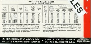

I found some data on your compressor looks to be 15.33 cfm at 550 rpm 3hp motor or 21.17 cfm at 760 rpm 5hp motor

Thanks for the info. Regards Barry
Barry,
Time how long it takes to go from 0 PSI to cutoff PSI. What is cutoff PSI anyway?
33 gallon tank?
With that info I can get some CFMs for you.
Also time how long it takes to go from 80 to 100 PSI, I can get an estimated CFM @ 90 psi as well.
We can compare to what the new specs were. Neat compressor.
