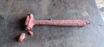

Not sure on the age but I now know to avoid anything made of “compothane”. It just shattered like that from falling out of a tool bag? :scared:

No idea but this was the common failure of early COM-PO-CAST hammers which were the first of the shot filled or steel skeleton urethane hammers ever introduced. This division of, I believe Stanley Black and Decker, was spun off from SBD and is now Trusty Cook. The urethane formula has been changed since these were first introduced and this type of deterioration is no longer a problem for at least 10-20 years from the date of manufacture.

He passed over rhe winter and after cleaning out all his totes, bags, and boxes to my barn, I have been slowly trying to organize and inventory everything. Pulled a tool bag off a 6gt shelf, and in the jiggling this little guy fell out and hit the concrete.
Kind of a shame, it looks like it would have been ha dy for fine work. Handle was/is 8" and head was/is 2"x4"

Not uncommon for those old dead blows, the plastic material breaks down and falls apart.
Some have blamed the solvents used to clean them after use but I kind of doubt it.

I had an earlier version of that Blue Point deadblow hammer for years -- found it in the highway in the 1980s and it wasn't new then. I'm guessing yours is 1990s, maybe late 1980s, maybe early 2000s. That's a guess.
Like many polyurethanes, when they start to degrade it's an unstoppable, catastrophic process. Mine started to get a little gooey, and within a month or two it had completely come apart. Pity -- it was my favorite hammer.

"Compothane" turned to "Compost". Similar to the "Stinky Handle" screwdrivers issue. Oxidation.

The degradation of polyurethane is more commonly referred to as "hydrolysis", not really oxidation. The mechanisms for PU deterioration involve moisture in the polymer and breaking bonds that form the urethane. It can be pretty dramatic in how fast and how throughly something will fall apart.
This link discusses mechanisms and shows some photos of PU safety shoe soles that have degraded. I has a pair of Blundstone boots a couple of years ago that made a helluva mess in my closet when their black PU soles turned into a gooey, crumbly mush as the fell off the boots.
