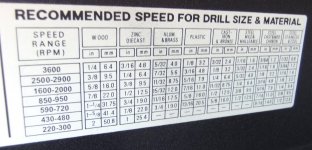

There is better out there. I found an early eighties HF #38142 for $40. It needed a motor and pulley, which I had. Pretty happy with it.
When I'm in the market for a DP, I look for the low speed center pulley (220 RPM) and a table elevator.
