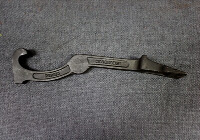

My wife found a wrench today, marked "Peoria" "Malleable" on one side, number "320" and "Gas Shut off" on the other. Any thoughts?? Looks bronze like...

The curved hook is similar to a "Hose wrench" used to tighten the smaller hoses used on a hydrant. I'm a dinosaur and have never seen one of these in the fire service but it may have been a "combi style" tool used in cities where gas was common in order to secure a building during a fire...

It's a multi-tool. Spanner for tightening/loosening hose couplings, hammer I guess for - hammering, If you look at the face you will likely see a rectangular depression or hole - that's the gas shutoff. Also works as a door wedge for holding doors open during a search, small prybar for, well, prying, and some have a small spike embedded in them for a glass breaker.

It’s a spanner wrench for 2.5” and 1.5 “ fire hose. The gas shut off is in a wedge end in case you need to pry something small. These are usually mounted in pairs with a hydrant wrench on fire apparatus. That said, the civil defense logo cast into it certainly makes it older and interesting.

Spanner wrench for fire hose.
The modern ones are made of pyrolite, an aluminum alloy. They still have the pry end and utility shut off but in my experience it is rare to see them used for anything but tightening / loosening hose couplings.

Interesting. Probably was part of a kit issued to auxiliary fireman for civil defense.

It is a civil defense spanner. Due to the war rationing of materials like brass, a lot of the firefighting equipment was made from ductile iron or steel.
