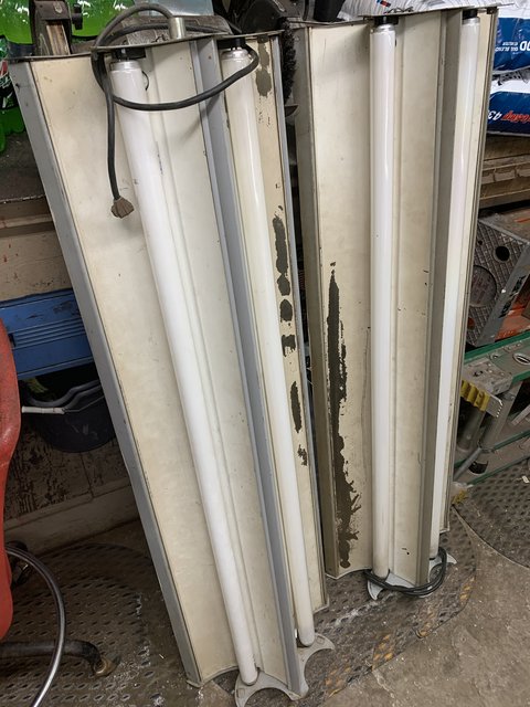

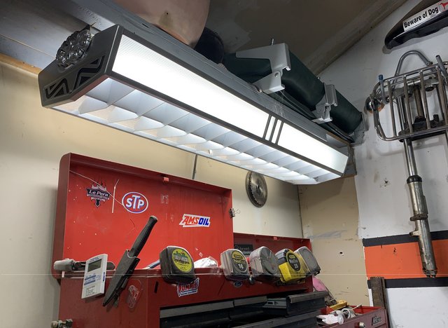

Found a couple of old lights on craigslist. Cleaned then up and hung them in the garage. At one time there was a lens/diffuser with them. i cant seem to find any info on these with my internet searches. I changed these over to LED because I need them to work in the cold.

They are preheat F40t12 so that's '40s or early '50s. Personality I have a hard time seeing them converted to led. I've got some F40T12 preheat stuff and they fire right up in freezing temperatures. I love them. I've some with ballasts from the '40s. The old ones are very reliable.
If they still have preheat ballasts let me know. I am interested in this sort of stuff. I keep an eye on Craigslist but non molested ones don't come up often.

All the old HPF ballasts have pcb oil in the capacitor. If it's not leaking an oily substance it not a hazard. A little tar leaking out shows it's probably been abused at one point by leaving dead lamps in or by using 34W lamps. They often last decades like that. Tar leaking is not a hazard.

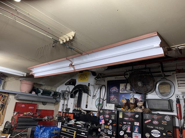

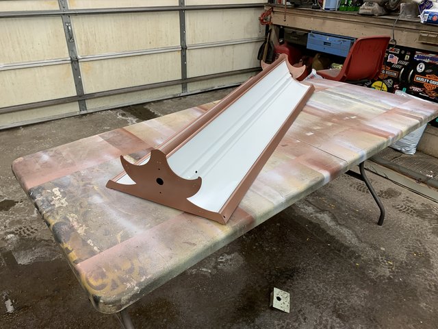

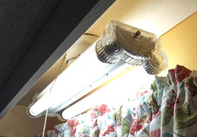

Here's a few that are in daily use. The row mounted ones are mid-late 50's, the others are from the 40's. One of the 3 row mounted lights has a replacement ballast, the rest are completely original.
