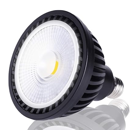

I think if you get something like this you can have single fixtures and a lot of light at the right place:
It's actually a swimming pool light but there are similar for regular fixture use.
