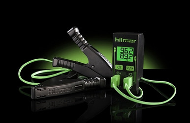

I was ready to say BS myself but there are active converters apparently. Good to learn something. Of course there is yet another battery to be dead when one needs it.
For my retirement use I think I might try one of the dual reading clamp on models of thermometers available on the jungle for less than $50.
