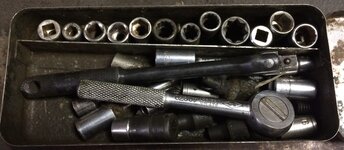

Finally got around to servicing and cleaning up my two new black ox 3/8" drive 4050 ratchets. I wish I knew when/where each one was made since they both have subtle differences between them.
Anyone know how to get the grimy rust colored stuff out of the name stamp? I used heavy duty simple green and scrubbed them both with a nylon scrub brush, then rinsed with water and dried with compressed air. I didn't want to do anything that would strip the finish.
I have found that Por15 degreaser works so much better than simple green. Its also not hazardous. I have no issues scrubbing clean the tools like that even with just a nylon brush with the por15 degreaser in my slop sink. Give it a try if you can. They sell 1qt spray bottles all the way up to gallon jugs. I buy on ebay mostly but I've seen it in auto part stores too.

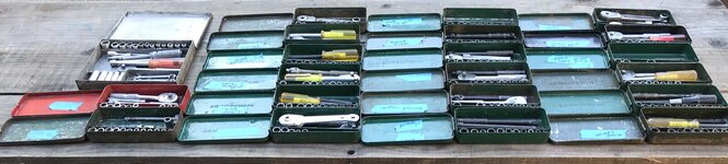

Heres a 1/4" drive chrome ratchet with USN in electric pencil
Here's the box that I have in my keeper GMTK. Dull green, no FSN stencil, 5 knuckle hinge, and looking fairly new on the inside.
Here's a box that I picked up at the flea market. The old man (retired veteran) was doing small engine repair and while he was talking to someone, I took the liberty of going through his toolbox on the back of his truck. I found the dull green FSN stamped box with 5 knuckle hinge in his toolbox with some big WW sockets and an SK ratchet along with a number of odds and ends. He didn't want to sell, but eventually I made an offer that was worth it to him.
30,796
This turned out to be so awesome!
Indeed. And maybe a little more than you realize! :)
Pic 1 is the box I mentioned upthread. Of the untold numbers of Walden sets we have seen in our community over the years with no way of knowing what was original and what was not, it is considered to be the one with the best provenance. The current owner bought it on eBay directly from the family of the WWII vet whose name you see scrawled on it at the top (Raymond Wozniak). That's the Navy PT-190 torpedo man I mentioned upthread. Dark dull green box, like yours. The tools that were original to the box when he got it were a spinner, a hinge handle, and 6- and 8-point sockets, all black ox. As I mentioned upthread, he thought it was missing pieces - a ratchet, an extension, and a sliding tee, which he promptly found in black ox, but what he got from the Wozniak family in that dull green FSN marked box was a perfectly acceptable and almost certainly original 1945 spec set.
Your box may have passed through some other hands between R.W. Peiffer's family and you, so I am hesitant to trust the provenance of the tools as much, but it is the second coolest box I have ever seen, and I definitely put it in the same category as the Wozniak box, if maybe only with a little less significance. :thumbup:
Pic 2 is a little chart I made a loooong time ago. I am posting it to give you some background on why I am interested in the specs on the sockets that came with your set. You see that fourth column? That is the specs for a late war set, from a late war GMTK manual, when the components were individually specified for the first time. I posted it earlier in reply to OTG's NOS set. The third column is from a midwar GMTK manual, which was only listed at the set level. I had to derive the specs for that set from the later set, a figure in the manual, in which you couldn't see the broachings to clear, and from other manuals, backing our way into it, if you will. You can see the Walden model numbers to the right. I'm interested in seeing how your sockets map to that column.

Agreed. In terms of markings, I think the knurled lines with Long W (going over the top of Walden) Worcester are the earliest, then very similar sockets with more of an inset, no Long W, Worcester, then just WALDEN, with grooves, no knurling, and I posted examples in that order on page 8, post #297, in a reply to Beemer. I don't think the order is of great consequence, except for the last type, which clearly extended into postwar production.
The finish is a different subject. I have seen steel, cad, and black oxide, I don't think there was any definitive, exclusive move from one finish to the other, nor do I think it's possible to exclusively associate one type of finish with one box type (dull green, or true green). Again, not to argue, but just to distinguish my position.
Very handsome set! :thumbup:
It's hard to not like the black ox look.
SK may have favored it as a finish even more - and for the curious, they had three successive contracts with the Ordnance Dept running from September 1942 and ending in April 1944.

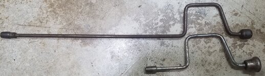

I found a couple of Walden Worcester speeders at an estate sale Saturday. The longer one has no markings, but with the 9/16" hex opening and a shaft length of 20", it has to be a 6218. The shorter one is marked 6064, and also has a 9/16" hex opening. Both wrenches show up in a 1923 catalog excerpt listed at archive.org. They are listed as usable on Model T Fords.
Note the difference in the knob at the rear end of the handle. I have noticed that WW used many different knob shapes. The knob on the 6064 is different from the 1923 catalog illustration, but seems very much like the 1923 square drive brace socket wrenches. The knurled knob on the 6218 is machined from solid steel, and seems later. I have also seen many WW "brace" tools with the hollow ball knob made from two stampings welded together, and wood knobs. The hollow ball design shows up in the Stevens-Walden Number 263 Handbook of 1928. WW seemingly couldn't decide on a knob design.
