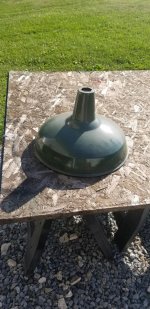

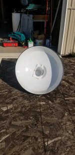

I have been looking for a little while for some vintage outdoor lighting for my pole building. I have always like the gooseneck porcelain style lights. Whenever I would find some though they were always beat to heck, way to expensive, or to far away.
Last week though I was able to score some 5 NOS porcelain light shades. Now I need to aquire the remaining pieces. I found these sockets https://www.barnlight.com/accessories/hardware/socket-assembly-coupler-7-wire/
but at $49 a pop I was wonding if anyone came across anything else like them and where I could find them.
I also need the gooseneck part as well. Was thinking of getting someone to bent some EMT and then paint it, but the above website also has that in powder coat which would be better for durability.

The arms were galvanized threaded conduit. EMT isn't really heavy enough if you want it to last like the originals.

I would bet barnlight is not making there own sockets so you just have to find them with out the barn name attached and I'm sure they will be cheaper.

Some of those need an oversized top flange -- the holes in the shades are big. The reproduction stuff sold today will not fit many of the old "real" stuff. I got mine off ebay --used --- in perfect condition. The flange has a grommet -- and the pipe is .. regular heavy pipe. I did a couple with straight pipe ... that is a nice look as well depending on the building
