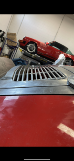

Progress on the targa deck.
Cutout got tipped in on the Pullmax to make the shape for the grill. Doing it out of one piece is challenging when you’re dealing with double crowns. Takes forever.
Grill mounted. And the rear fin is there so we can establish heights.
Love this grill with its different angles and heights. Here Alex has the rear transition bent and welded into place. Now he can establish the shape of the rear duckbill relative to the grill.
Final few days of fab work on this one. Then time to clean up all the edges Ang get it ready for paint.

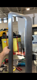

Update on the targa. Customer changed his mind on the wing (happens from time to time) and wants to go with a RS style spoiler. Makes it tough on us as our deadline to paint is next Monday. We build these custom cars start to finish in 9-12 months turnkey from the drop off. All of that time is planned out and the deadline isn’t movable as we have to stay on schedule as a business. ***** for the staff but it is what it is. Most important part of that pivot is the first hour of the notification that there has been a design change, and the game planning and start of the execution resulting from it. A huge problem in my space is custom cars taking years to do, but there is no need for that. One of my sayings in business is you can make a Million but if it takes you a year you haven’t made any money. GOTTA GO!
Started by bending some sheet into an angle on the magnetic break, then shrinking it on the power hammer to get the curvature of the cutout identified.
Both lower corners shaped in roughly so the team can identify the base height of the RS Spoiler. That MH-19 makes short work of those complex curves. What a tool! It kind of ***** in rigid mode (that is why we have the pullmax) but as a regular hammer it’s fantastic.
rear template in place to identify the height. Luckily we have a real Carerra RS in for some engine work so templating was a lot easier. You can buy re manufactured tails, but they are all glass and the fit is horrible. They are so bad i dont even know how these places stay in business.
Shape is laid out and ready to cut.
This brings me to a point. People ask how we keep such a clean shop. Mind you we are a small staff and CRANK out the work. It is situations like this photo, I sent and email to my shop foreman with this photo pulled off our photo cloud. Email subject was “whats wrong with this picture”. It is messy, the floor is dirty, and the countertop is dirty. I know it drives them NUTS that this is how I am, but I am PICKY.

Update on the ferrari. It is finally finished with the Megasquirt to Motec conversion. Challenging engineering project but the team was able to get it done. Made some good power at 308 to the wheels so the client should be happy about that.
One last thing to wrap up was the throttle body Venturi's. Really horrible execution by the previous shop, just leave it at that. They were machined out of paper thin aluminum, no base gasket, and there was a piece of wire mesh cut into a square at the base of the venturi acting as a screen. Cannot make this up. Fine for some people's ability but not Olsen Spec.
Drew it up - material spec's are billet 6061. One piece with a removable top screen. Held in by 3mm Torx headed bolts.
Once machined and made sent them to be hard coat anodized (we never use anything except hard coat) in matte nickel. I wanted to do gold, but the client felt that was a bit to flashy (come on BRO it's a Ferrari!!!!!!!) :rolleyes2
Here is a photo from the bottom, this is test fitting stage before sending them for Anodizing
Installed and dialed in.
The only thing I do not like about this finished product was the rubber vacuum lines from the ITB to the IAC plate. I really wanted to do these lines hardline out of 8mm conifer, would have really dialed it in and made it look factory, but just wasn't in the budget. Sometimes thats the way it goes!
