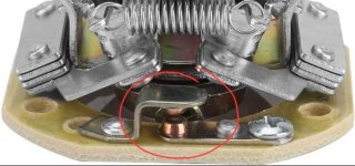

djbmw
Jun 20, 2013
1,247
Ottawa, Ontario, Canada
Take the motor apart and look for burn marks on the windings, or on the contactor/centrifugal switch.
A humming noise means that something isn't getting the electrical pixies that it needs - likely due to bad contact (from burns, debris, damage, etc.). Pop it apart and snap some pics. My tire machine motor had a burnt out contactor (last pic below) and would hum/buzz in a certain position. A few passes with sand paper and it was up and running within 20 min (I also cleaned it before re-assembling).

Here are the contactor points, I gave them a pretty decent sanding and am still getting the same results, it can start about 2/5 times regardless of pressure in the system or not, I'm going to try to get the rotor out but something is holding it to the compressor so I'm guessing the shaft is bolted straight to the connecting rod

djbmw
Jun 20, 2013
1,247
Those look good. How are the windings, rotor, stator, etc?
I dont see a start/run cap (im also on my phone and on the road so I cant really look at the images/tread in detail) so I imagine the motor uses a commutator. What is the condition of it, and the brushes?

Did you look at his pic? The contacts look beautiful. As long as they make contact with eachother, they have life left (hundreds of thousands of on/off cycles).

The thing about electrical contacts is they're typically plated with silver or some other metal, so sanding can remove that plating which will shorten their operating life. They'll work, but they'll corrode and/or deteriorate quicker from the small arcs that happen each time they're operated.

djbmw
Jun 20, 2013
1,247
Perhaps they are on some motors (based on quality/power?),.. but certainly none that I recall working on. If you look up brand new replacement centrifugal switches you'll see they are bare copper (image attached for reference).
Edit: i was able to find a few silver plated ones (image attached). They seem to be more commonly used on older quality motors. Most mass produced motors that come with innexpensive equipment seem to be using straight copper though.
