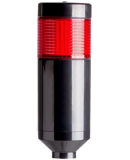

Several have suggested getting a relay. I'm not seeing why. My impression is the intent is to have a light that is on when the wall switch is sending power to the compressor. For that you just need to wire a 240V light in parallel to the compressor power line.
A relay powered by a switched 120V circuit would let you put lights or a switched out let + lamp on the same circuit that powered the relay. That may be helpful if the intent is to tie turning off the shop lights with powering down the compressor. However, it seems more complicated vs just adding a 240V neon or LED lamp. If the compressor is in a visible location the 240V light could be wired to the pressure switch instead of the wall power switch.
Here is a multi-voltage (including 240V) stack light. Attach this to the compressor and tie the power lines into the leads going into your pressure switch.
