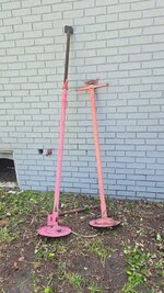

Safety Under the Lift.
I've only put 1 car up on the lift - the 3,000 lb. Mustang. It feels rock-steady at 6 feet off the floor-not that I've pressed the issue. The car is nose-heavy and I have it on the asymmetric arms "backwards" - meaning the long arms to the front of the car.
My lift is 9,000 capacity so I feel it's capable of holding anything in our fleet, but I wanted a little more stability when it's time for the 4,000 lb. mini-van, or 5,000 lb. pickup. So - I've been casually shopping for under-hoist jack stands online and it seems the Taiwanese-sourced 3/4 ton stands range from $65 to $115 depending on the retailer. Occasionally they do appear on Face_place and I landed this mis-matched pair last week :
They had been left outside for some time and I really only examined lower end to see what sins the faded powder coating was hiding. Finding no broken welds or significant rust, they followed me home and went into the shop. Only then did I realize that the screw jack portion and the cast steel hand levers were rusted together and wouldn't budge.
Each of the acme-threaded jack stems was given 48 in the electrolysis tank, which did great at removing the surface rust from the bare steel, but it didn't fix the issue where the parts were oxide-joined. Each one was soaked in a 50-50 acetone-hydraulic fluid mix of penetrant.
Needing a way to hold these over-sized wing nuts while twisting with leverage, I clamped a length of square steel tubing to the car cross-member.
Then made a special "wrench adapter" that would slip over the "head" of the screw.
Made from an equally-rusted scrap of 2x3 tube.
this tube was rotated by my largest (18") import/knockoff crescent wrench that I bought 20 years ago to overhaul a transmission.
Success! They didn't even see me sweat. It's time to start the cleanup and re-assembly.
There were clues to the original thrust bearings and races included. The wingnuts ride against these bearings at the top of the jack stand body tube.
The skeletal remains of the thrust bearings were given an electrolysis / wire brush / lube treatment but didn't seem recoverable, So replacements are on order from AmaCon. Thus raising my inve$tment 20%.

Painting the bare spring in its stretched yoga position. As pre-Woodstock Fords were primarily satin black underhood , these parts will blend in or look conspicuously new-ish.
What’s the deal with spray paint cans? I used to buy the 78-cent per can generic stuff at K-Mart and paint 4 bicycles and a model car!
Now- 1 or 2 coats on 2 parts and it sputters out dry and empty.
MARKSTANG
Feb 4, 2014
124
Myrtle Beach, South Carolina
Ready to go under the car
New thrust bearings were delivered, measured the same as the old bits.
Proper fit between the tube post and the screw. The bearing rides in a cup-like race, similar to a bicycle frame in the one stand, the other just sets on top of a thick steel cap.
Assembled and ready for usage.
The burgundy paint (to cover the faded red powder coat) was selected because I had a lot of it. Left over from the covid-era tailgate party trailer quarantine project. I'm hoping it will be visible enough and I won't trip into/over them, since my cataract and replacement lens surgeries, my peripheral vision on the right side is a little narrower than it was before.
