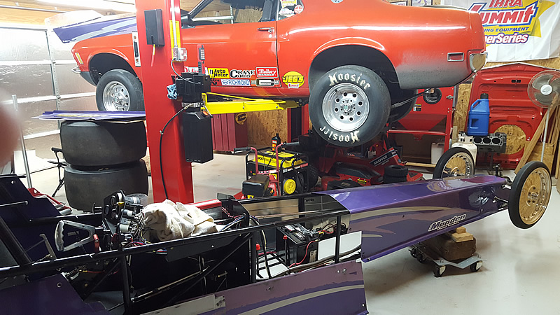

I considered a Max. As above, went with a base plate and very happy. Cheaper and more versatile. This is mine and my ceiling is 96". If my ceiling was 112" like your's I'd have a lot less mods to do. My posts are only 111", so there you go.
$1727 picked up with my trailer at the warehouse.

Also FWIW - that part of my shop is 28 wide x 24 deep. The lift is 24" off the wall and 136" wide. I can back the other door car (the Falcon) in through the 16' overhead and clear the post easy. So having a big post in the middle is not turning out to be much of an issue. The dragster has a 235" wheel base and by playing musical chairs with the other "stuff" like the mower and such, I can swing it around and out the door.
And a warning about owning a lift - if you have a lot of ongoing "projects" pretty soon you'll discover extra floor space. :lol:

Falcon67,
Awesome coupe. Do you have an emergency shut off in case the momentary switch fails engaged? I'd hate to see that Mustang crunched.. or trusses busted.. or both.
I put a handy outlet on the control post and included a DPST 2 HP rated switch in the line to the power unit. Stays off when not in use.
The joists are 2x12s on 24" centers, it'd likely crush the car before busting those timbers LOL.
