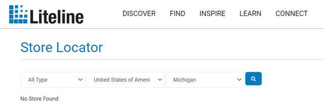

Thanks for the tip! I took a look at the Liteline site and they have some fancy stuff. They did not have any retailers nearby, and I don't really need super high style. I would like quality - any of the more commonly available stuff worth looking at?
-Joe

Quality lighting stuff is sold thru electrical supply stores. That's where I'd go. You can call liteline and ask for a local reference. Or call Crites-Tidy Associates 616-647-2400 and ask them for prices. There are many other similar outfits. You wont find anything of decent quality at any of the big box stores or "retailers". Just cheap junk.
You can try a chandelier shop near you, but they'll probably rob you.
Looks like you've almost got a museum there! Good quality lighting will really enhance it!
