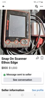

There is also this one close by ethos edge for $800. Looks rough tho. Current update he has is 19.2. But claims there is a 19.4..... how much would that cost to get?

The Ethos Edge will be cheaper updates than a Solus or Modis but won't have service info. I started with an Ethos tech before I got my Solus Edge. It looks like Ethos updates are $817.
