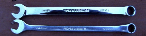

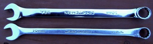

Does anyone have pictures they can supply of the SK version and the danaher version side by side?
Pictures of new Danaher Craftsman Pro (top) next to old SK Craftsman Pro (bottom).

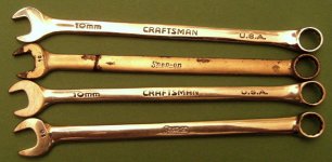

Also SK Craftsman Pros next to Snap-on wrenches.
I have a lot of wrenches. There are differences between them but mostly I grab whichever one is close when I need it.

Thanks MAD, the differences are easily distinguishable. Appreciate the photos.
