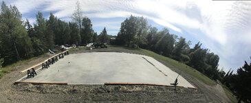

This panoramic of my 40x60 shows the sawcuts defining my shop into thirds. The left and the middle are flat, with the right third sloping one inch in twelve feet down to a 28’ trench near the big doors.
I cover the trench with bar grating, and pump all the snowmelt out a couple times a winter.
Do you have the shop built now and how do you like this setup?
