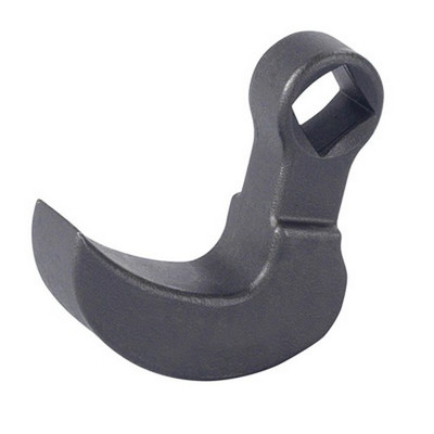

If I didn't have any pry bars, I wouldn't start with indexing pry bars. I'd pick up a set of Mayhew Dominators for starters.
Depending on what you work on, indexing pry bars can be quite effective. They do have some drawbacks though like the head size, pivot pin strength, and handle fork strength.
Another option would be pry bar head you can use with a ratchet/breaker bar.

Come'on guys have you never heard of "The Devil's Finger". Check out Fed's link above. This is the answer. Small, light, easily carried can be used as a seal puller and as a prybar for removing oil pans.
8
809
Aug 21, 2021
251
I didn't know about this thing until today. I'll definitely buy it.
