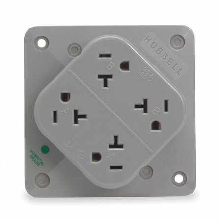

Yes, install a quad to cover all bases. This one has hot on top and bottom:
This one has ground on top and bottom:
