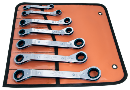

Not what the op was looking for, but some very good information about their early designs. (From an old story of mine).
29,599
A & E / A & E Inc., 5501 21st St., Racine, WI / https://www.aeincorporated.com/ est. 1932 / patent 2500835 Mar 14 1950 & 4748875 Jun 7 1988 & 4819521 Apr 11 1989 John W. Lang / http://alloy-artifacts.org/a_e_manufacturing.html / patent http://alloy-artifacts.org/a_e_manufacturing.html#history / http://toolarchives.com/node/366 / see also Kastar, see also Lang Tool /
Kastar / see A & E, see Lang / https://www.garagejournal.com/forum/threads/kastar-tools-made-in-the-usa.8971/ /
Lang / Lang Tools, 5501 21st St., Racine, WI 53406/ http://www.langtools.com/ / see A & E, see Kastar /
Langline / see Lang Tools /

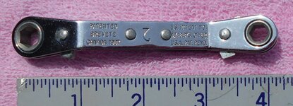

A & E, Kastar, Lang - all the same company now, still manufacturing these with any number of brand names stamped on them:
dnschmidt
Oct 3, 2014
7,325
Phoenix, AZ
^^^^^ Right. They were also ugly as hell and only had about 20 positions in 360 degrees but that was better than nothing when they were the only game in town prior to Goodwrench.
