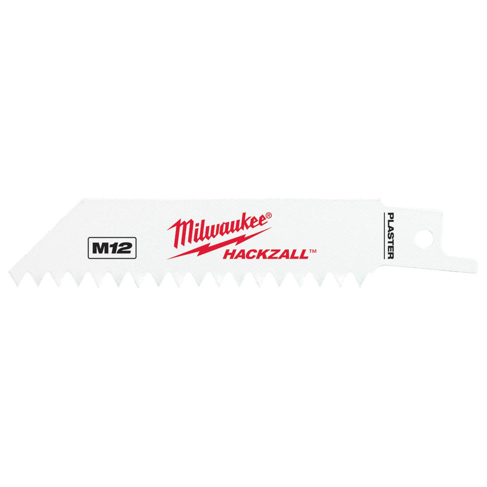

Yes. I cut up pieces of something like this:
and welded it to dulled blades.
At the time, I was cutting rectangular holes in my plaster over metal lath stucco walls, and these made an awful job very bearable.
