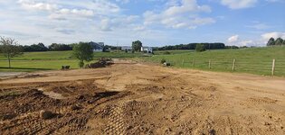

The wife and I sold our 40x100 last year and I've been renting half of it for 10.5 months. Our new shop has to be done before a year is up due to the purchase agreement agreement.
So the old shop was a steel frame building. The new building is bigger at 48x100, stud frame style concrete poured walls.
Here are some starter pictures. So cause of the lay of my land we have to basically cut into a hillside. The south wall is about 8' tall.
