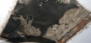

I bought a new front door fixture to update the recessed old light that was from years ago. Usually its very straight forward to remove and replace with the new fixture but when i removed the recessed can i noticed their was no junction box to use the mounting bracket on the new fixture. Also i have a huge gap from the recessed light.
Its about 8" inches across from the side to side. I've seen recessed lighting to pendant type conversion kits but don't know if that will work. Any suggestions how to make this work?

Recessed lights usually do not have a junction box. They are directly wired to the fizture as you have found out.
What I would do, is get a fan mount bracket ( the type which expands it's gripping teeth into the ceiling joists as you twist the center bar ) and use this bracket to mount an octagon box where you want the new light to go.
If you need to, patch the oversized opening with some outdoor rated plywood, patch and paint to match existing. Then hang the new light fixture

There was no junction box necessary for that fixture. You're in a pickle.
Are there ceiling joists up there? If so, you can get a retrofit ceiling box like Raco 936. You'll still need to patch that huge hole.

No ceiling joists, its an extension piece off the front of the house. See the images. Any other suggestions?

How about cutting a piece of 1/4 inch plywood big enough to cover the hole and overlap about 2 inches all the way around. Square or round..your choice.
Then cut a hole in the middle of the patch and install an old work box. Looks like you might need to extend the wires.
Then attach the patch with construction adhesive and short screws. Some filler will smooth the plywood edges. Or use molding. Prime and paint.
This might trigger the need to repaint the soffit in that area to better match up. It would on my 70 year old house. :)

I expect the easiest would be to make a plate overlapping the hole, the plate could be either 3/4" exterior-grade plywood, or metal. Use structural fasteners like SPAX screws to fasten it to the soffit, then mount your new light fixture to a new steel box in the center of that.

Actually looking further in the hole i see wood on either side i don't know if you call i joists but wonder if i can take grounded-b's suggestion and use a Safe-t-brace for ceiling fans in the link below. i assume i just run the wires right through the plate?

The framing supporting the soffit plywood would be your roof rafter tails.
They’re probably 24 inches on center (measure!) so keep that in mind when looking for electrical box mounting hardware.
You don’t run the wires through the plate, you cut a hole in the plate the same size as the electrical box. The wires go through the box and are secured with a cable clamp. The box is supported by your framing. The plate is just to cover the big hole left by removing your old fixture.
I assume you want the new box to be flush with the soffit.

i got about 21" from side to side, yes i would image it would have to be flush to the soffit
I don't know of a metal old work box built in an octagon style. The plastic O/W boxes aren't meant to be used with the armored cable.
ANY box will have to be mounted flush, or project beyond the plywood (because plywood's flammable).

If you want things to be flush you could just take a length of 2 x 4 slightly wider than the hole. Put some shims of plywood on each side to give the depth needed for the new work metal box screwed to the 2 x 4. Put in the hole and secure with a couple screws on each end. If you need to close the hole put some lumber or strips of plywood around the edge behind the existing plywood. Then screw plywood to fit the hole and putty/caulk around the edge if it will show. I wouldn't be supporting huge fixtures or fans that way but it's plenty strong to support a modest light fixture. The flex conduit that went to the old fixture goes to the new metal box.

I would do similar to a drywall patch method but using wood instead. Cut a couple lengths of 1x4 and screw in place to act as backers. Cut a square of plywood of the right thickness (or shim as necessary) to fit into the square opening and screw to the wood backers (countersink the holes a bit). Cut a hole in the plywood square patch to fit a rework box and secure the box. Use wood filler to fill the small gap around the patch and the screw holes. Sand smooth and paint- install the new light afterwards.

Good suggestions here. I rather try the ceiling expandable mount between two joists, I just don't know if it will flush enough. Do I need be concerned safety wise going this method?

You will need to mount a box in the center of the hole for the fixture to mount on. You can use a remodeler fan brace that will extend rafter to rafter and has prongs that will stick into the rafter when tightened, as already said. Or fill it in with plywood, cut a 4 inch hole in the center and use a plastic remodel box. The fixture needs to mount to a ceiling box, so there are no open splices.

would it not be flush with Safe-t-brace bracket once the arms are extended?
The bracket is designed to leave the octagon box flush with the finished surface. It is designed for 1/2" drywall, so your 1/2" plywood will end up the same.
You will have to look at the instructions for the fan brace, to see if it calls for a 1 1/2" or a 2 1/8" deep octagon box.

No. The fixture he showed, uses a fixture strap and a 1/4" pipe ****** to mount the fixture.
You mount the strap to the box with 8-32 RHMS and the fixture mounts to the ****** with a small locknut.
I would add a couple of wood screws through the back of the fixture into the plywood, to keep the fixture from rotating out of square with the soffit.

ok ending up getting an expandable ceiling fan bracket with box. Please see the pictures this will dig into either side of the joist/roof. I will tighten everything up then push the wires through the box and wire it up. Then bolt up the fixture. Anyone see any issues electrical wise or safety?
I also assume the wires out of the existing fixture hopefully are just white, black and a copper wire for grounding?

You WILL need an armored cable ( BX ) connector and an insulated bushing (Red Head ) when you connect the cable to the box.
And, yes, it will be black to blacks, white to whites, and bare copper grounds to green ground screw. ( BX does not have a ground wire internally, it grounds through the armor)

How come you need a armored cable ( BX ) connector and an insulated bushing (Red Head ), this bushing in the image came with iti assume that will not work. Is it b/c its armored cable? So i once i feed the bx into the connector it will ground it?

That is a non-metallic, push-in connector for "Romex"
Yes, in order to maintain continuity of the equipment ground, you need to use a listed connector for armored cable (BX). The "red-head" is use to protect the conductor insulation from the sharp edge of the BX armor.

Are you sure you are even qualified do DIY electrical?
This is baby stuff. Basically you need a 1/2" BX connector and a "red head" for whatever size BX you have. If I had to guess, I would be 95% sure it is 14-2 BX.
And before you ask, Yellow #74B wirenuts would be what I would use to splice the 3 fixture wires to the #14 black and white wires in the BX. ( your mileage may vary )
