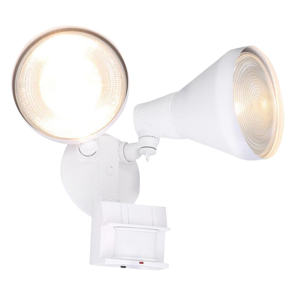

I have four outdoor flood lights on the back of the garage and house. Each has two led bulbs with motion sensor. They come on when motions detected and shut off after a few minutes. They also have a solar sensor to prevent them from coming on during the day.
Last year one just stayed on all the time and would not reset. I replaced it with a new one. Yesterday another one is doing the same thing. Is there a way to repair it or is it best to just replace? Thanks for you input.

You can replace the motion sensor. Probably about the cost of the whole unit though.

SOMETIMES a when you have multiple motion sensors (cheap ones) on the same circuit they "play games" with the other ones and cause malfunctions......... I suggest using RAB motion sensors that have been field proven to work unlike the cheap Chinese ones.

Do you have the instructions ? I have one that does the same thing every once in a while and there is a procedure you have to follow to "reset" it. I think its basically turn the power off and then back on in a certain sequence.

Thanks, I powered it off for a day and back on. Just stayed on 24/7. So is it the photo cell bad or the motion sensor?!?
most of the cases it would be the relay inside that is stuck... but you can probably bench test the coil end and see if there are voltage constantly applied to it...

Some motion lights have special modes you can put them in. For example, the motion light on our house is setup so if you turn the switch on/off 3 times rapidly, it goes into "normal light mode" and it just turns on/off with the switch.
You might want to see if you can find the instructions to see if your light supports that feature.

Well, I finally took it apart and didn’t see anything burnt on circuit board nor spider web on lenses. Leaned lenses and reassembled. Said to myself reinstall and if it doesn’t work then I’ll buy a new one. Low and behold it has been working fine for over a week. Thanks for all the input.

I have some of the Home Depot/Lowes motion sensor lights as well, and have had them act like the OP has described.
What I found that works for me is to set the ON time of the light to one of the other settings for a few days, and then put it back to the ON time I had it set for before.
By this I mean, most of my lights are set to stay on for 1 minute after they stop sensing motion. After a few years the lights would just stay on all the time and never shut off after sensing motion.
I tried all other options posted here by everyone, and they worked, sort of, for a short time. And then I tried just setting the ON time to something different and the lights always seemed to start working properly again. Only now the light stays on for a few minutes longer.
Then after a few days I set the ON time back to what I had it before, and the light works like is should again.
You already took the light apart and cleaned it, and now it is working again, so you are good to go. But if the same issue happens again, try setting the ON time to one of the other settings and see if that makes the light work again as it should.
