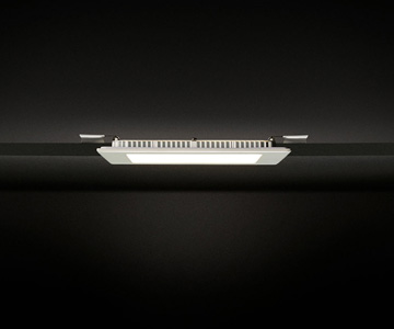

Liteline makes probably the best can-less product on the market today. Just connect the driver and snap in the disc. Outdoor rated. Lots of sizes and lumen packages.
https://www.liteline.com/20000068-pf_slm/slim-pro-series/slimled-fixtures/filter=3000041331
