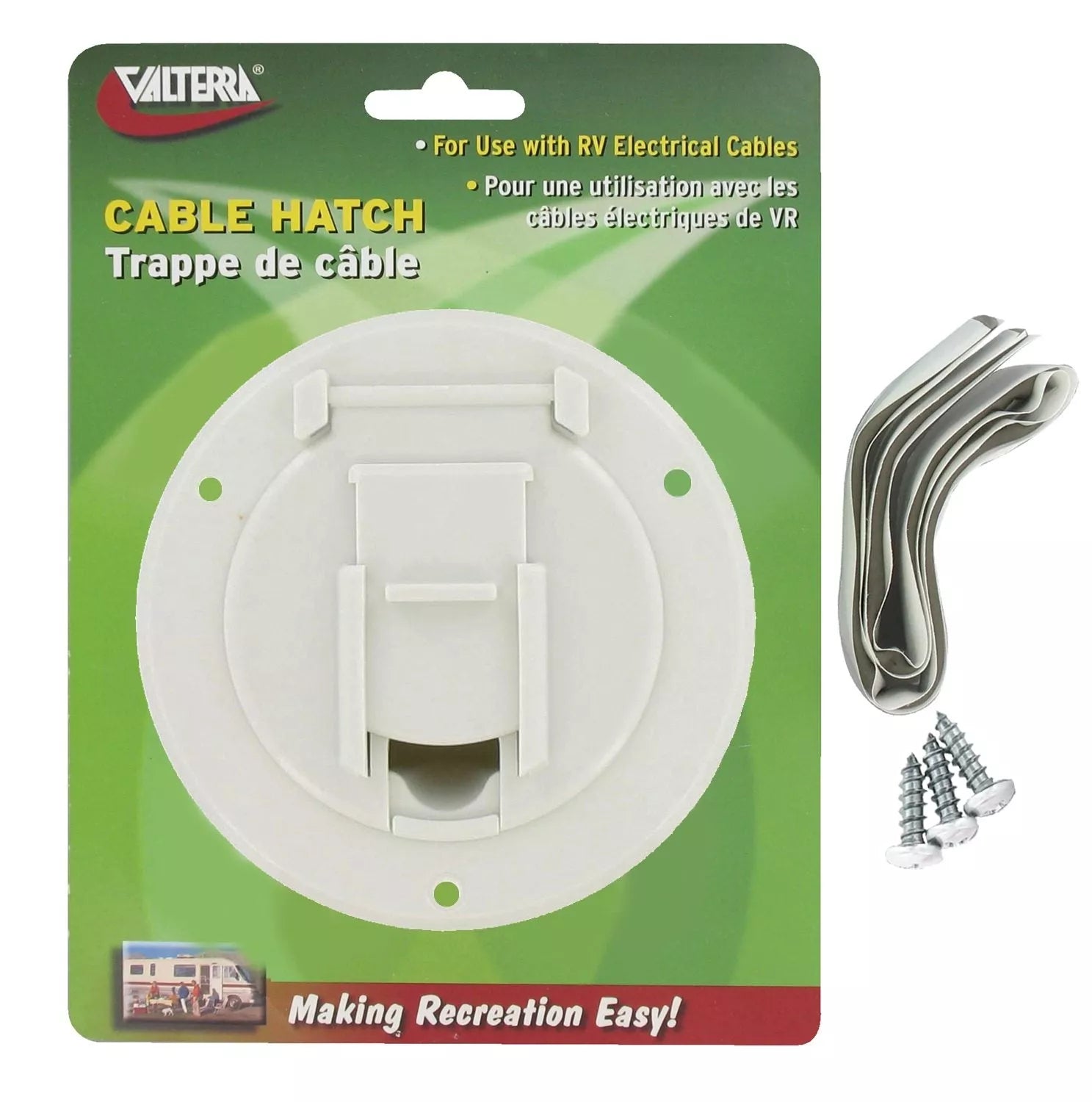

Got a 100' hose on a reel that hangs on the inside of one of my doors. Going to use one of these for outside access right under it. Open the hatch and poke the hose out and pull as required.

I bought one of those intending to use it. IMHO, it’s flimsy and I didnt use it.
