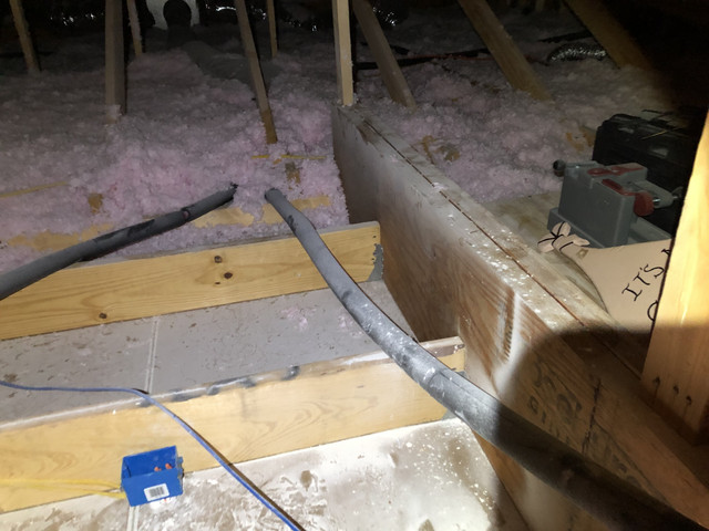

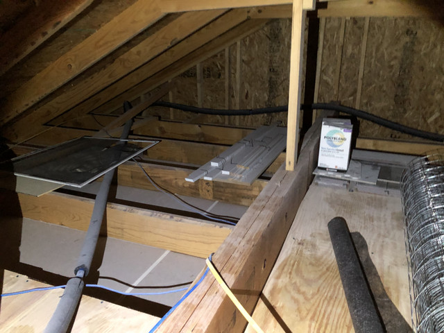

Hello,
Moved into a new house this summer and just now am getting around to organizing the storage space above my garage. So far, I've placed a couple of 3/4" plywood sheets up there for light stuff (gun cases, extra trim, seed spreader, etc). Only now am I wondering what the actual load capacity might be up here.
I don't plan on throwing engines or something up here, but I'd love to be able to cover the rest of the floor in plywood and store more stuff like a miter saw, wife's garden tools not used much, and extra totes to get **** out of the house.
I'm not much on building specs, but the attic floor appears to be 2 sandwich LVLs spanning the center a double wide garage with 2x8's coming off of that to the outside walls.

Should not be a problem! Your ceiling joists look sufficient for about anything you could carry up a ladder...

You can use a floor joist calculator to figure out how much 2x8 can be spanned for a given floor dead weight. Chances are it will hold a whole lot more than you'll feel comfortable hauling up there.

IMHO, The 3/4 plywood if anchored to the supporting structure will make a diaphragm that should evenly distribute any load you are going to pack up there.

I looked one up, but I'm best guessing. No clue what grade lumber I have but it appears that for a dead load of 10psf the maximum span is 9.5ft which is around where I'm at now.

Probably a good way of looking at it. My miter saw is probably 40ish pounds and that's about the heaviest thing I'd be putting up there.

This is mostly to soothe your fears. At 10 pounds of dead load (very conservative) a 10' x 10' area should be able to carry 1,000 pounds.

This. But with 2x8s, and given what you want to put up there, I wouldn't worry about it for a second. When you start loading it up, perhaps time to look up what the nearest equivalent span is loaded for.
