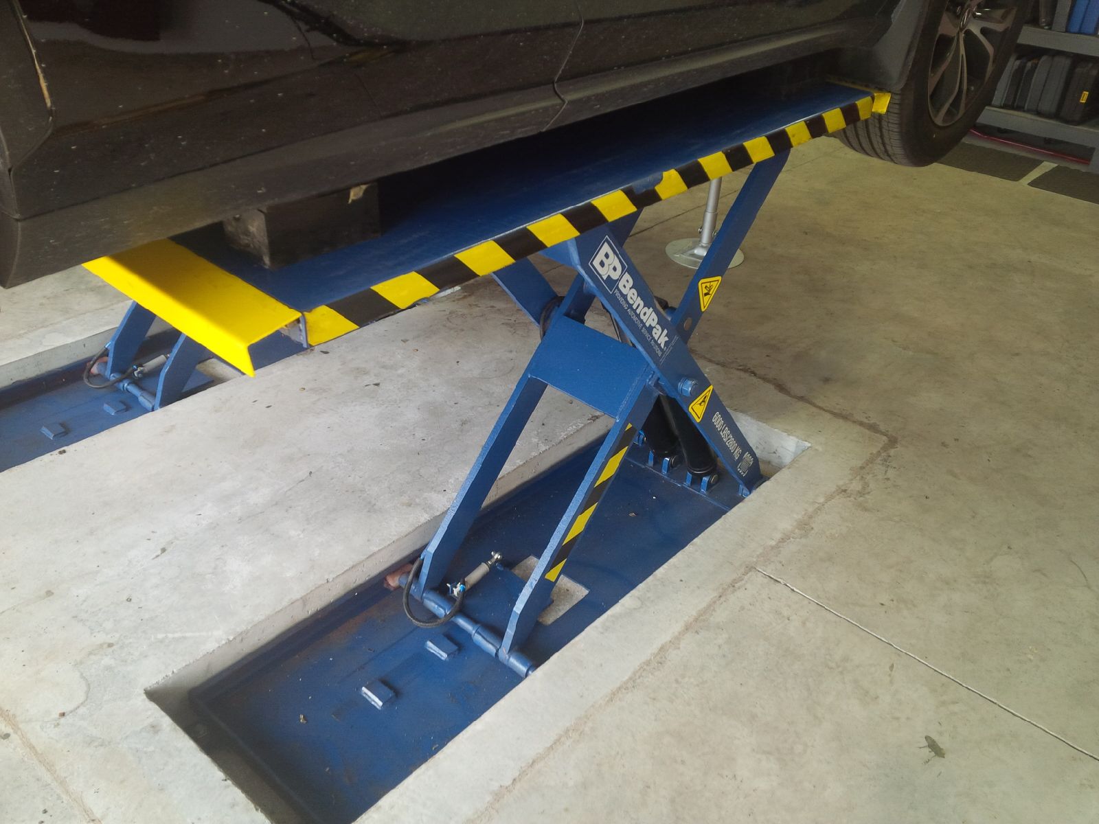

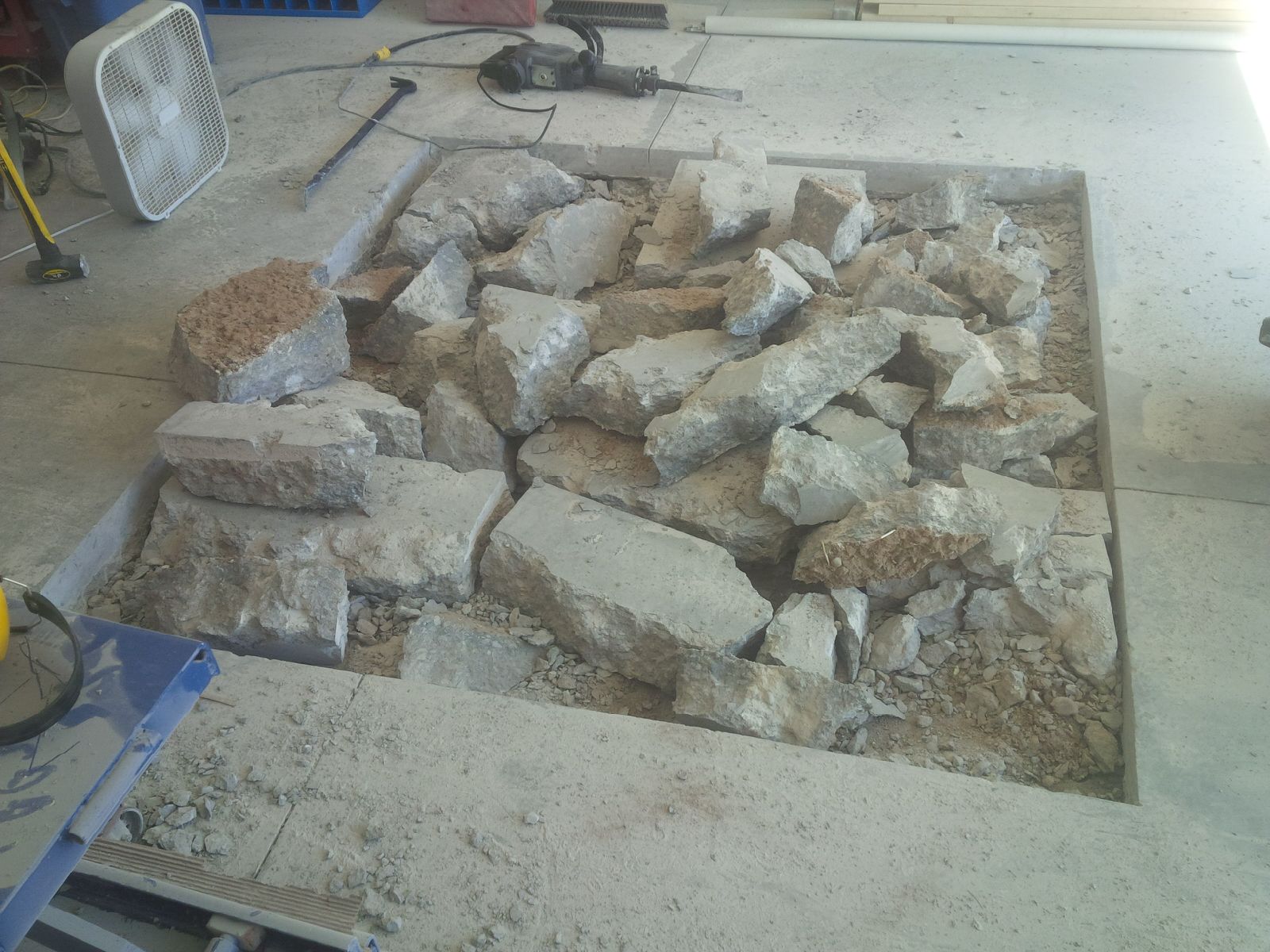

Yeah, that's it...I designed and built this myself in the spring at my house...only part I hired out was digging the holes.
Last year I installed my Bendpak flush mount scissor lift...including cutting and breaking out the 6 inch slab with my demo hammer and my concrete saw.
