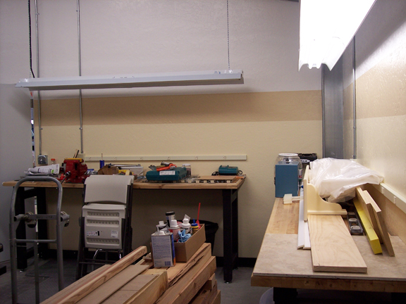

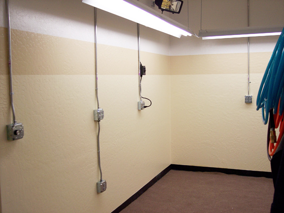

If you'll have workbenches along the walls-I'd hang twin 96" T8's over them just above head level. Otherwise-the ones you have laid out will cause shadows-as mentioned "Dark Areas" towards your walls. The 8 foot fixtures having 4 each 4 foot T8's yield more shadows over a twin tube fixture.
Here are two shots from my project which is still in-progress:
Above: You can see that the overhead lights cast a shadow at bench level on the bench that does not have the 8 footer lit. The other bench is well lit without shadows. The back edges of these fixtures are 12 inches from the wall.
In the tool room, where I will have sit-down benches and tables, the fixtures are spaced out from the wall a little more. There will be 3 Gladiator wall cabinets spaced apart on each of the 3 walls in this room.
Hopes this helps and illustrates the point of wall shadows from overheads placed inboard opf walls.
