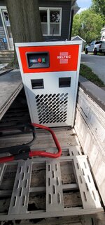

Perusing FB marketplace and stumbled across this compressed air dryer:
Seller says it works, filter change light is not on but he bought new and never changed it so will need it eventually, light usage in home shop

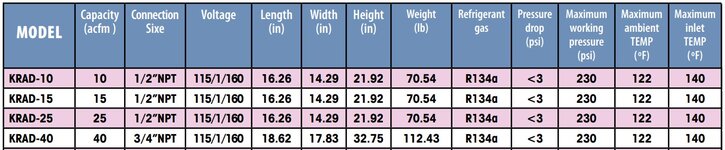

Based on their current sales lit, it appears to be the 40 CFM model:
It seems like stupid overkill for my 5 cfm compressor with intermittent usage in a more woodworking/house repair based garage. No painting, sandblasting or even heavy impact tool usage....
But it's $100 and is around 30 minutes away....so it's awfully tempting
Main question is....what is the risk or downside on these in an intermittent usage environment on something that is so oversized? I'm plumbing the 3 car garage right now with Rapidair, but I still doubt I used compressed air for more then a couple times a week for air tools or blowing some things off etc...some eventual light usage operating some small pneumatic cylinders. Big compressors generally like to just run and run so I'm assuming the same is for the dryers?
I get that it's insane overkill....and I shouldn't go after it and just put a normal air filter/regulator/dessicant dryer on and move on....but if I did do it...what's the downside to a dryer in this type of application?

I think these are rated off of a baseline on temperature and humidity. Change either one of those and 40 cfm is not 40 cfm is is quite lower.
I run a Quincy 325 through a Quincy 45 cfm dryer and it works well with no problems. I do live in HI where it does get hot and is midly humid. Had the came set up in CA and it worked well there too.

There's no real drawback to being over-sized and you'll be ready for when you upgrade the comp!
Dry air is a blessing in the shop.
I'm fortunate in that my workspace is air conditioned, so no loss of capacity due to ambient... But yeah the adjustment factor for derating capacity based on input air temp happens quickly

I don't know about this air dryer but with most AC systems there has to be a way to divert the refrigerant if there isn't large enough heat load on the evaporator. So there is either a thermal mass, variable speed / capacity compressor, or hot gas bypass or a combination. This is the problem with having an oversized ac unit.
For my garage I just have a 60 cfm dessicant dryer coming. At the rate I use the air it'll last forever before I need to recharge it.

Well it's home:
Seller would likely fit into this crowd well. Working out of 2 shops with a variety of car projects in process...came from working on a Willy's, Chevy Square Body panels and trim were laying around as it was coming back from paint soon and there was a straight 6 out of a Plymouth that was just refreshed on a stand. Trying to reorganize where he did what work and was moving the metal working/welding/fab and this didn't fit in the layout so he wanted it gone...so I obliged. Dolly and pair of ramps made it easy to load up
Now what to do with it...it either ends up in the purple box shown here:
Or at another home if I chicken out...if so first shot for it will be to the farm shop as it's the right sized for the compressor there.
Either way...keep any compressor related advice or feedback coming....I'll probably move the saga of "where does it go" to my main thread in my signature here...but try and toss anything dryer specific back into here.
