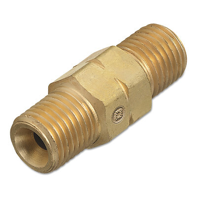

i have 3 sets, of small oxy/acet set ups. 'mc' acetylene and 'r' oxy cylinders.
the small portable rigs.
im retired. im not going to use these. im going to store. i have caps for the regs and handles, plus those are going into tote tool boxes.
the hoses, id like to put a coupling on each, and store hanging in carage, to keep bugs out of them.
i've determined the threads are 3/8 x 24, L & R. trade designation is 'A'. the bigger set ups are 'B'
only place i can find, is mcmaster, who only have the acetylene, left handed one, #7905A5. i cannot google foo 'a' fittings. every search turns up various garden hoses.
cyber weld, harris, ebay, amazon - nuttin.
a little help, pleeze.
see if these will work for you
western enterprises #130
western enterprises #131
metaldad
Aug 2, 2011
7,753
nw indiana
thats them! thanks
