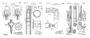

What I did find was that Hubert R. Crane was issued a number of patents, all of which relate to pipe.
Your "expanding mandrel" is a device to expand the end of a pipe. (see swaging)

Mine is like fig 3 in the first image, with only two pieces that move. Seems like that would cause the pipe to expand unevenly. Trying to expand galvanized pipe with this tool would require a lot of force, and there's better options for tubing.
Me thinks "expanding" on the patent refers to the action, not the function.
