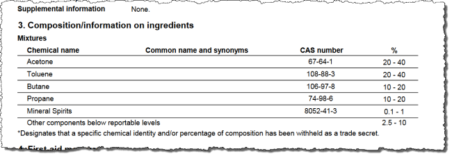

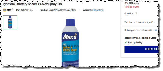

NAPA MAC'S IGNITION & BATTERY SEALER 1067
Can you access the SDS? (PDF): https://media.napaonline.com/is/content/GenuinePartsCompany/3210573pdf?$PDF$
Many thanks, WWheeler :thumbup:
Although I was unable to access the NAPA website due to, afaik, changes introduced by the EU concerning data protection/tracking, I was able to open the SDS page.
Looking at the ingredients, 2 are gases and the others seem to be solvents/de-greasers, so I'm wondering what is acting as a sealer?
The nearest product available over here seems to be 'Damp Start' for use on Ignition Systems. I'll give it a try and see how it works.

The main ingredient is acetone. Doesn't acetone destroy plastic?
Acetone (nail polish remover) comes in "plastic" bottles. I never bothered to examine the chemistry, but I would assume different "plastics" react with the acetone. Temperature, length of exposure, pressure et al being factors.
Good question. I tried to google it and wikipedia turned up this about cellulose acetate:
acetate is soluble in many common solvents (especially acetone and other organic solvents)
That said, I think the handles we refer to as acetate are cellulose acetate butyrate which I didn't find anything referring to acetone but did find this:
https://www.azom.com/article.aspx?ArticleID=384
The disadvantages of Cellulose Acetate Butyrate include:
Attacked or swollen by many solvents including chlorinated and aromatic hydrocarbons, alcohols and ketones
Anywho, I'd probably avoid using an acetone product on them.
I've had Craftsman screwdrivers with these handles for more than 30 years. Never really had the smell be an issue or even noticed it except when new. Never cleaned, treated, or sealed them with anything other than the occasional wipe off the crud with a rag.
