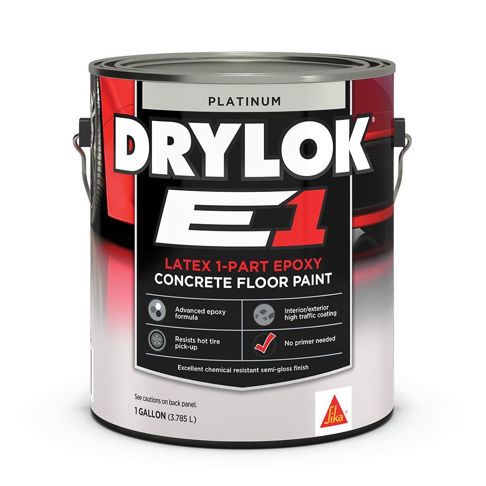

Hello, I've got my garage floor and all other parts (small stem wall, small apron lip and landing) ground and patched and ready for epoxy/paint.
I'm on a tight budget and I've got a 2 part epoxy flake kit that will cover the main floor at about 320 sq ft. The thing is I doubt I'll have enough left to use on the landing and the outside apron lip. I never planned to use it on the short stem wall area.
So I'm looking for just a gray paint that I know won't match exactly but I don't care that much about matching. Just good adhesion on the ground concrete.
I was considering these two products:
Drylok E1
Rust-oleum
The main floor, landing and apron would have a top-coat of 1 part polyurea or similar.
Obviously one product is oil and one is latex based but other than the apron, it'll be just foot traffic on the landing.
Thanks for any advice on the paint.

You don't want to use epoxy on the outside apron anyhow. It will turn yellow (amber) and eventually oxidize from the UV rays. Either of those choices will work and not be affected by the UV rays since they are not a 2-part epoxy coating. I would suggest matching up the finishes - semi-gloss or gloss with the epoxy you are using. It will most likely require two coats since the concrete was treated via grinding.

Thanks Shea! I was wondering on the apron, as I've seen many people use their epoxy and some not. Will my topcoat of 1 part polyurea or similar topcoat provide UV protection for the main floor where I will be using the good 2-part epoxy system? There will be some sun exposure on the leading edge near the outside apron.
Thanks again!

A polyurea clear coat will still allow UV rays to penetrate through to the epoxy. However, it typically will slow any ambering that may occur. If it's a quality epoxy, the ambering process will take longer as well. The budget water-based epoxy kits are the ones that are most susceptible and at a faster rate.

Is there any clear topcoat product (urethane, for instance?) that would do a better job of UV rejection? The sun is only going to be more intense as the years go on down here in TX.

Unfortunately, no. Clear coats do not act like a sunscreen. The clear coat will not amber, but the epoxy can at some point.
