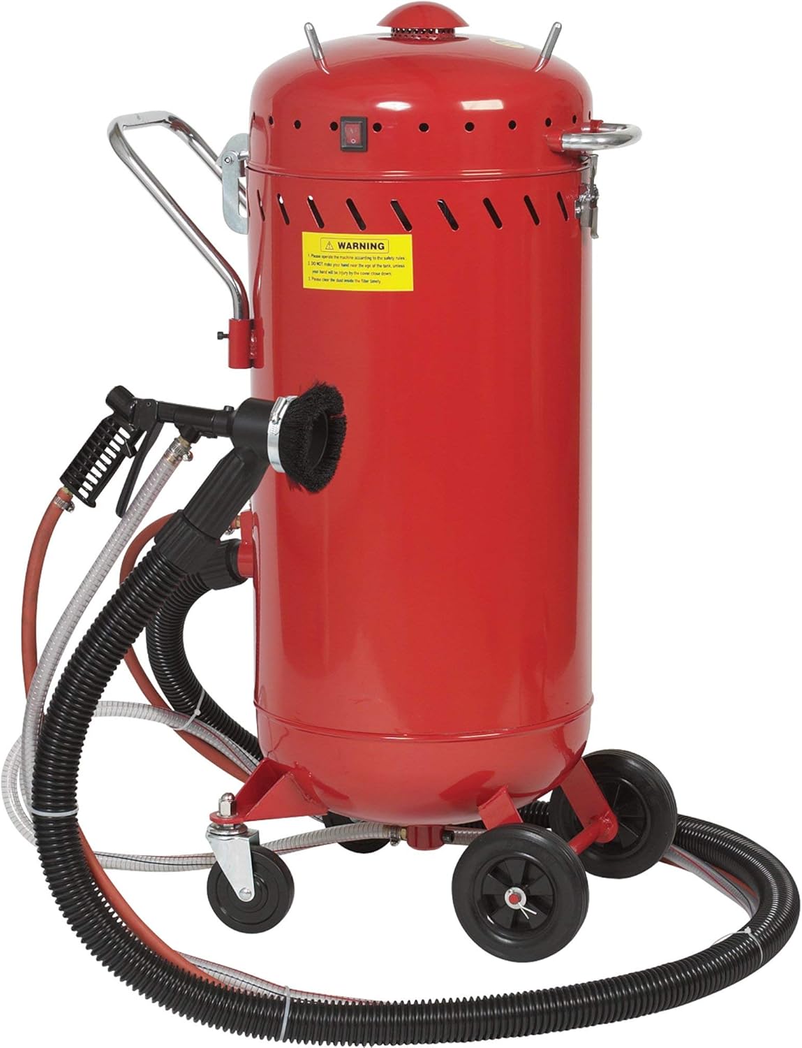

I had a similar issue removing centuries of peeling paint from wood beams and flooring in an old log house. I got a vacuum blaster and used walnut shells. It worked quite well. There was still some mess, but it was much, MUCH less than you'd get from a conventional blaster. Hint: the cheap walnut shells from Harbor Freight worked better than the expensive ones from TP Tools.
I'll also add that I bought this blaster for about half what Amazon is charging in this ad. Shop around.
