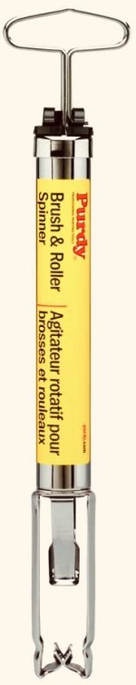

Do you have a roller spinner? Greatly speeds things up.

Good roller covers are 10 bucks a piece and it is fast and easy to clean them.....as a pro, I had to clean covers daily when I had paint jobs going. The spinner and a cheap kitchen spray nozzle in a utility sink was key. A brush comb and sprayer for brushes that cost 20 bucks each. New roller covers **** as they can shed. Thinner is expensive so i would roll out the new roller covers on something disposable or hidden in case there were any loose fibers.
My frames and covers got cleaned every day even if using the same paint the next day. Keeping clean and well formed tools is vital to being able to do a nice finish and cut in with precision.
Lambs wool covers are great for water based finish. They hold a lot of paint, don't splatter much, don't shed, and last for a long time when cleaned and dried well. They would last years for a home owner.
Some people are afraid to spray the inside of a brush, but good ones hold up fine if shaken out by hand and hung to dry at least overnight and put back in the sleves to keep their shape. Not washing well enough causes build up and stiffness. A wire brush cleans the ferule and bristles and a steel comb untangles the bristles before shaking out.

Then use a brush comb or a spinner or put the roller on a frame that is on a roller pole and spin the roller with leaf blower.

Ok, the consensus is to clean rollers (and brushes of course). I've never tried a spinner for cleaning, have to look into it. I just applied a PVA sealer over drywall on 2 walls, and it was a cheap roller. It worked fine and cleaned up ok. I've used the bags and refrig method and it was fine for continuing work. I did see some tips here that I'll keep in mind. I appreciate all the suggestions.
