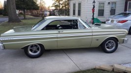

Please do show some more pics of the 64-65 Falcon. I've had 4 of them and would love to see more of yours.

1965 351 bored and stroked to a 427. Toploader 4spd and 4:11 with Detroit locker

Totally missed the Falcon in the initial pics. Too focused on the garage floor :p
That is sweet! I've been talking for the last 5 years about doing something similar, but with a 347 stroker.
