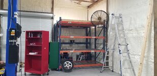

Probably not necessary to mount to the floor or the wall.
I think your first idea is more useable. But the high shelves in the rear might be tough to access unless you leave plenty of room between for a ladder.
I have 14' walls and bought 8' high racks. I put a 30" deep rack against the back wall, with a 48" deep rack parallel to it, about 2.5' apart. Then I built a wooden deck across the two for more storage.
On the other side, I have a 30" deep rack that I turned into a work bench with shelves above and below. I even built some drawers to mount under the bench.
