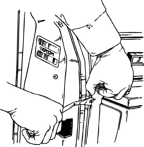

Are you saying that the auto trim removal tool below is a best tool to use on panel clips?

In the Schwaben 5 Piece Trim Removal Tool set, what do you use the wide tool and tool with the circle at the end for?

In the BRAND-X 5 Piece Trim Removal Tool set, what do you use the wide tool and tool with the circle at the end for?
I've used the wide tool for pulling up large trim pieces, gently working it from one end to the other.
I'm sure the ring-end tool has some special purpose, but I can't say that I've found it myself.
