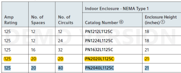

I have a Siemens CB panel PN2020L1125C, that specifies 20 spaces 20 circuits. But it accepts QT (thin) breakers. So my question is, does a double pole 240V breaker count as two circuits or 1. Can I put 10 240V breakers and 10 120V breakers in this box?

It looks like I might be getting some AI BS. If it cant take 30 circuits can it be converted to 30 circuits. 1770058517841.png

Your stuck at 20 with what you have.
The enclosure is the same height so yes. As long as there are no design changes to the buss mounting provisions or enclosure.
Buy the 2040 and open it up to compare between the 2 panels before touching any wiring.
Siemens doesn't make a 2030 within this immediate product family.

Its actually confusing the diagram inside the box implies that I can convert mine to 40 circuits by installing ECNBX kit(s). But in the scenario I proposed 10 240V and 10 120V, I would have enough grounds and neutrals as is. Differences in pictures between the 2020 and 2040 appear to be the installation of a longer ground bar and another neutral bar.
On the other hand I have a 2448 box that calls out the QT. So the question now is, buy installing the ECNBX kit, is this box now a 2040.

It could be the exact same box as the # of 1" spaces are same.
Swap out neutral and ground bars too, if the buss mounting means are identical.

Looking at the pictures the 2040 has a neutral bar on both sides and a longer ground bar. The 2020 only has a neutral bar on one side. The label states it can be a 2040 with added neutral bar or possibly if some of the breakers are plug on neutral so wouldn't fill the neutral bar. Same size box.
